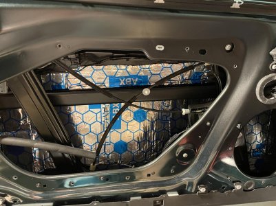

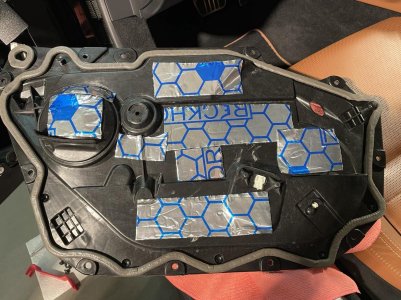

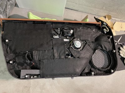

Got a little 10kg package from the German company Reckhorn yesterday, spent most of last night in the garage and finshed today. Added insulation in the doors and also some in the boot. The main point was to improve the conditions for the sound system and eliminate a little buzz in my new driver's door. Since I had the material I also looked into reducing NVH resonance in the mid/back of the car but without overdoing it to not risk eliminating too much of that glorious exhaust noise.
A decent layer of resonance reducing ABX alubutyl on the inside of the door skins and a few more areas plus covered most of the door cards with sound absorbing/decoupling 10 mm DV-10i. Waiting for the weather to improve before a proper road test but initial sound tests are very positive.
The Reckhorn ABX seems to be a very good German alternative to Dynamats and was super easy to work with. Many thanks to ralphr1780 for the tip about Reckhorn.
