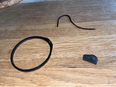

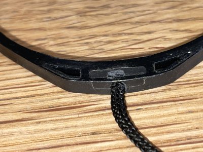

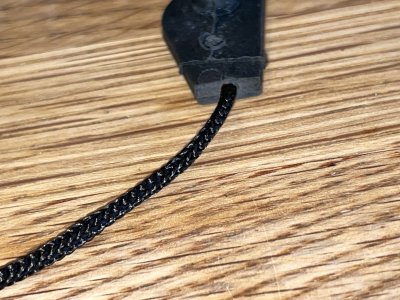

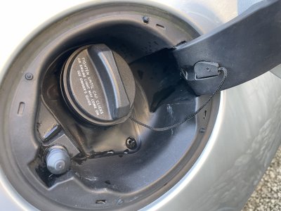

Fixed the crappy rubber fuel cap lead with a small drill and the platted cord from a freebie sunglasses bag
Cut to correct length, melted ends with a flame to stop fraying. Cut the broken rubber one off. Drilled a small hole in both parts and superglued the cord in.

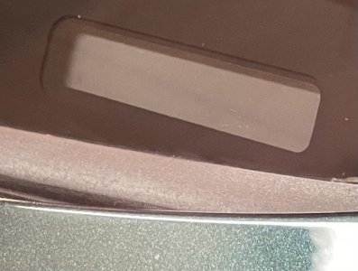

Covered the VIN display in the windshield. Just doesn't seem like a good idea to publicly display the VIN of the car even though mine never sees any unsafe places. I never got why JLR does this on their cars.
Had a spare piece of rubber mat which I previously also used for added insulation around the engine cover, cut a suitable piece of it and slid it in between the dash and windscreen. It's large enough to easily be poked out of the way with a card or piece of paper.
