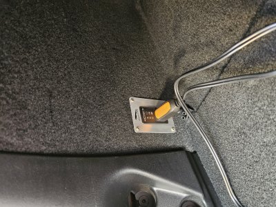

If you prefer an easier to reach version I installed it in the boot on the liner underneath the opening
