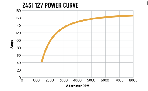

For example, an alternator output curve is shown below. It may not be identical to the one used in the F-Type, but it's similar in terms of rating and behaviour. Note that the speed is for the alternator, not the engine.
If we assume the car’s pulley ratio is approximately 2:1, this means that for every turn of the engine, the alternator spins twice. At an idle speed of around 850 RPM, the alternator would be turning at about 1700 RPM, which is less than a third of its rated power. However, as RPMs increase, the output from the alternator rises quickly. Full current may be reached by 2500 - 3000 RPM, but that's not an engine speed the car typically cruises at.
