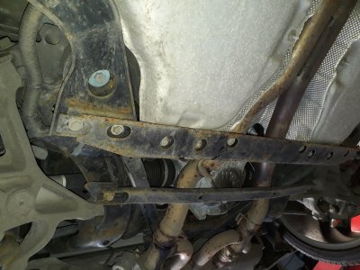

Rusty rear cross brace
Hello
Great work on the rear diff metal chassis work .. well done
although mine does still look like that after a year old from new ... also does look like a diff oil seal issue (have you a warranty still ?)
hi folks, yes the wax was done before the bolts were put back. and yes the mechanic pointed the screw in plug for the diff,apparently these are not seals but the screw in bolt is tapered so just needed tightening to seal properly ? I will keep my eye on it, has anyone else had this on theirs,regards,mark

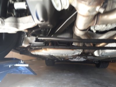

this was a before pic on my car, 4 months old demonstrator when I bought it, been in a carport since then, rarely seen water !https://www.ftypeforums.co.uk/download/file.php?mode=view&id=2406

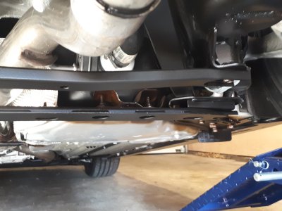

Spent the day getting steel work looking good.
Nope. You ask the dealer. They have to sent in pictures. If its severely rusted it can be replaced for every age of car.
If you have a problem & no warrantee left remove the parts & take them to be sandblasted & then on to the chrome platers who will zinc coat the parts. They will last forever then.

Has anyone ever removed these parts? How many bolts and fastenings, are there any tricky parts?
Exactly my question - it might be a spring weekend job to clean them up and hammerite them.

Mine looks not too good either on certain Places (not as bad as the pics above though), even though I do not use it in winter conditions (salty roads). So I have just had a talk with a friend of mine that runs a bodyshop/workshop and has specialiced in anti-rust/corrosion treatment. He said that he could treat all affected areas with a special primer that will react to and stop the rust that has allready occured (since the rust does not go deep on an "almost new" car, so no sandblasting is needed). Then he will spray all appropriate areas with another "stuff" (and not Mercasol which they usually use for the "everyday use car") that gives a thin and almost transparent layer that looks a lot better than the Mercasol - and has almost as good protective properties. It should be more than good enough on a car that is not used on gravel roads and in winter time. As soon as our roads are dry and clean from salt, I will take the car to his workshop and have it done. It will give some more "peace in mind", as this car is a keeper for me
Hi,
In my opinion these braces have to be removed to get a good result in protecting them from rust. They are constructed with box sectioned steel and it is difficult to get to certain parts of the braces, such as the larger one that is behind the silencer. When you remove them the rust is quite prevalent under the loose paintwork, so this has to be removed to start the renovation process. 2 of the braces are easy to remove but the larger X shaped one you have to remove the silencer. This is not an easy job as this brace weighs 50kg+ and is hard to support by just jacking up the rear end or the car.
I agree should of been a recall, but it takes everyone to contact Jaguar at the same time to get a result. An to be honest the new braces are no better according to those in the industry. Case of getting a set treat properly yourself then asking someone to help you fit...
I believe JEC are monitoring the new braces and as far as I am aware there is not a definite answer about them. I ordered new ones and gave them an extra paint. After many emails to JLR they eventually agreed a contribution, so when this was authorised I got my local Jaguar garage to fit them at a cost of £117. The goodwill payment did not cover the whole job but to help with this I retrieved the old panels, renovated them and sold them on. The old panels had a lot of surface rust on them but were solid. My car is 4yr old and I am intending to keep for a long time so it was important to sort out this rust now.
