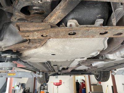

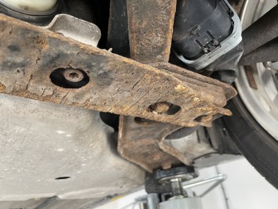

On the good advice of this forum I also checked the rear x brace and cross member which showed some very surprising levels of corrosion (pictures attached).
Anyway, I took the car to Jamie at Jagdoctor and had this replaced with a change of diff oil for a very good price. I can thoroughly recommend Jamie who is incredibly knowledgeable and helpful and was more than happy to check other areas of the car and Lanoguard the rest of the car whilst it was on the ramp.

Out of interest, how many miles are on the car? Just interested to know whether its use that has resulted in corrosion that bad.
Hello,
I wished it was use. The car has done 26k but I believe it’s a well known fault.
Not great though!

It's well known issue but rarely this bad on a 5 year old car. Mine is more than double the age and mileage and very little corrosion, so I'd struggle to say 'normal'
I'm sure the care afforded by a previous owner who judging by the longitudinal stipes has grounded the car out dozens of time.
Nothing that can't be fixed with some TLC

I recently picked up at MY16 car with 30k miles a couple months back and had concerns about the very same thing. I looked at it as best I could on the ground and negotiated the price down with a mind to getting it replaced. Once it was up on the ramp though it wasn't actually all that bad. It was basically just surface corrosion with the original paint coating flaking off so looked worse than I thought. So I was surprised to see yours in the condition it was. It could be based on where it's been used though. If it's spent a lot of time in areas with more rain or icy conditions where the roads get gritted more.
Sounds like you've got it all sorted now though so doesn't matter going forward.
Thanks for the replies and no offence taken at all.
By the mileage and history which was all one dealership in the North it didn’t get much use at all for a year or 2 so that’s probably the reason for the corrosion . Everything else under the car is in great condition (not scraped or rubbed) so no other worries on that front and now it’s all replaced and treated looks as good as new!
