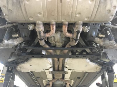

Having read about the rear cross brace issues on here I had the dealer send me a photo of the underside of the car I'm purchasing. Looks like it obviously had the same reported issue as they've given it a paint....It's a 3 year old car, 32,000 miles.
For those that know more than me does everything else look ok under there? Black marks on the exhaust?
I think that looks pretty mint for 3yrs/32k miles - i'd personally be happy given age and mileage and would say its mainly been used in the dry and not on gritted roads
I think the black marks on the exhausts is condensation water leaking out at the joints, maybe not 100% tight..
I’d agree with that. Small amounts of carbon soot washed out as residual moisture at start up leaks out
You’ll never seal the joints though -it’s normal when cold
Thanks guys. I agree I am pleasantly surprised how tidy it's looking under there. Mind you after I asked for a photo they probably panicked and gave it a good tidy up.......or if I'm being cynical took a picture of another car :roll: :lol:
That cross brace definitely looks like it has already been rust treated and repainted. Looks good underneath.
The exhausts have small drain holes to allow any moisture out. That's where the black soot marks are from.
Not wishing to dishearten you ahead of purchase, but on close inspection of the photo that looks like a pretty shoddy cover up to me ... shame they didn’t think to mask or cover up the rest of the underside as I see overspray to the floor pan, exhaust and other components.
I suspect that is little more than a quick rattle can spray to address your request, just as a valater would do or freshen up the wheel arch linings before putting the car on the forecourt for sale. For peace of mind I would plan to do it again when you get the car home if you’re really concerned about it ...
On a positive note the rest looks to be as you expect and pretty clean for the mileage ...

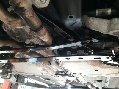

after all the discussions on the state of the underneath of the f types, I believe jaguar will probably do nothing to help owners, so I went down the independent route and had my local car repair shop take all of the metal parts and braces that he could , got them sandblasted, powdered coated then, when back on the car, every thing was waxoiled including framework and nooks and crannies, cost £200 but well worth it for the peace of mindhttps://www.ftypeforums.co.uk/download/file.php?mode=view&id=2396
Well done ! Did you spray waxoil on the 'blind' side of the bolts too [on top] ? That where water and salt gets in..
