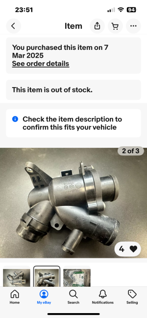

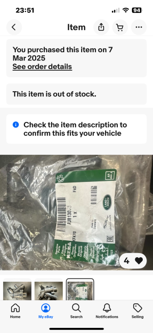

I have purchased the genuine aluminium y pipe and other cooling pipe as I have a leak have also purchased a genuine aluminium thermostat housing as well just to be on the safe side as cannot see where it is coming from till it goes into my indie next week will give an update when I know more
Any chance you could provide the part number for the genuine aluminium thermostat housing that you’ve purchased? If possible a photo of it would also be beneficial to go along with the others already included in this topic.
I recently had a coolant leak from the front of the engine on my car and it turned out to be the thermostat https://www.ftypeforums.co.uk/viewtopic.php?t=9061
Thanks Tony.
Could you confirm whether or not you purchased the genuine aluminium upper and lower coolant outlet pipes (Land Rover part numbers LR186859 and LR186917) from a JLR main dealer or elsewhere? If possible could you provide a photo of them?

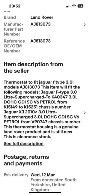

The thermostat you purchased on ebay https://www.ebay.co.uk/itm/266940534392 (part number AJ813073) is made of plastic and not aluminium. It’s for early 3.0 litre cars up to VIN ending K15251.
From VIN ending K15252 up to VIN K40346 (3.0 litre cars) the part number is AJ814048 as shown here...
https://parts.jaguarlandroverclassic.com/parts/index/part/id/152.1078.2455.11487/brand/jaguar/ and in the attached screenshot.
Also, from VIN ending K40347 and above (3.0 litre cars) the part number is AJ814048 as shown here... https://parts.jaguarlandroverclassic.com/parts/index/part/id/152.1078.2455.11486/brand/jaguar/
I recently purchased the thermostat AJ814048 from my JLR main dealer and had it fitted on my car. It's made of plastic and the current price of it is £89.71 inc VAT.
I’m aware that there are aftermarket aluminium thermostats but not sure if there's a genuine JLR equivalent to AJ814048 in aluminium? If this is what you’re after it could be worth checking with your main dealer?
Update: I’ve now spoken with a JLR main dealer about this and the Land Rover equivalent and compatible part number is LR117568 which is the same price at £89.71 inc VAT and is also made of plastic https://parts.jaguarlandroverclassic.com/lr117568-thermostat-and-housing.html

Hi RPSN this is the description for the add and photos purchased from eBay
Hi RPSN here are photos of the add and parts bought from eBay you seem a lot more knowledgeable about part numbers so any information would be appreciated before car goes in for work doing thanks Tony

Hi RPSN my vin number ends in K30844 on the add for the thermostat it does state will fit up to K40347 so in theory should fit but will double check with dealer I can return if wrong for full refund thanks for all the info will keep you updated Tony.
Hi Tony, yes I did notice the ebay ad https://www.ebay.co.uk/itm/266940534392 where you purchased the thermostat from states...
“Thermostat to fit jaguar f type 3.0l models AJ813073
This item will fit the following models:
Jaguar F-type 3.0 Litre-Supercharged-To K40347 3.0L DOHC GDI SC V6 PETROL from K15149 to K15251 chassis number”
However, as your car’s VIN ends in K30844 the correct JLR part number for the thermostat is AJ814048 as shown in the info I posted earlier. Even if the thermostat you’ve bought (AJ813073) fits your car it may be inferior to AJ814048 as parts can get upgraded over time? Is it worth the risk knowing that the F-Type is susceptible to engine cooling system issues?
