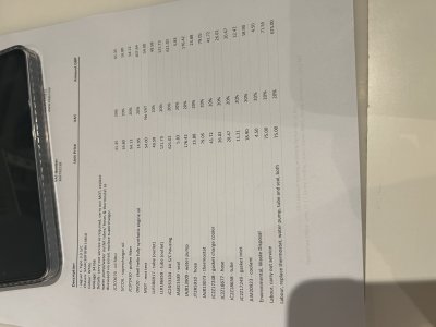

Car back from service & MOT yesterday. Also had water bits replaced, water pump, thermostat plus S/C overhauled including new SC snout & coupler.
They fitted the aluminium versions. They are genuine LR but are compatible with Jaguar. Posted a couple of pictures to share part numbers.

Thanks for the info and pics including the genuine Land Rover aluminium upper and lower coolant outlet pipes (part numbers LR186859 and LR186917) which are compatible with Jaguar. On the job sheet I see the thermostat part number AJ813073 which is correct for your VIN ending K14810 and is applicable to 3.0 litre cars up to VIN ending K15251.

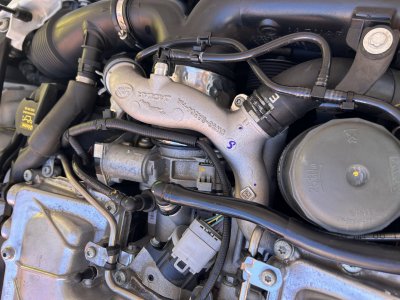

Any chance you could remove the plastic engine cover (if you have it fitted) and take a pic of the aluminium upper coolant outlet pipe in situ? This would be beneficial to go along with the others included in this topic.

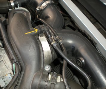

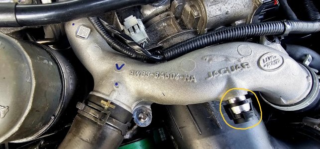

One of the reasons I asked if you could provide a photo of the genuine aluminium upper coolant outlet pipe in situ on your car is because I searched for one and came across this https://www.jaginfo.org/threads/oem-outlet-coolant-pipes.117946/ which relates to a Jaguar XF. It shows a section of the pipe that is capped off whereas it is not capped off on the plastic upper coolant outlet pipe on my car and instead connects to the coolant expansion tank bleed hose. Could you confirm what that connection on your aluminium one is like?
I’ve attached two photos. The first one is from the link above (Jaguar XF) and the other is from my own car.

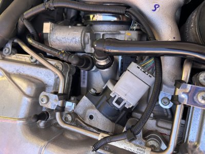

Let me know if you want more 👍
Good choice with the F-Type instead of a MkII Ford Escort and I don’t blame your Mrs for not wanting to be seen wearing the rally harnesses :lol:
Thanks for the pics 👍. I can see the connection that I spoke about earlier goes to the coolant expansion tank bleed hose which is exactly as it should be.
The genuine Land Rover aluminium upper and lower coolant outlet pipes (part numbers LR186859 and LR186917) you’ve had fitted should see you right throughout ownership of the car.
