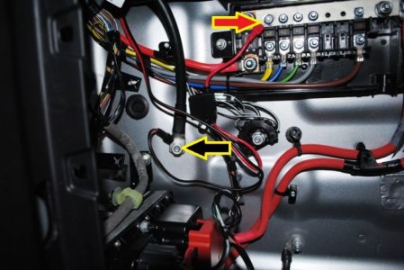

Until yesterday I've always attached my CTEK as the pic below, which I found on here previously. When I put it on yesterday the power light on the CTEK kept flashing and wouldn't work right. Anyone offer a suggestion as to why? I've ended up putting it directly to the battery and it appears OK.

There's a negative terminal near the jump start post, any reason you chose not to use that? I've seen one guy who's run a CTEK cable into the wheel arch so he just untucks it by the wheel to connect the charger, and tucks it away again after use.
