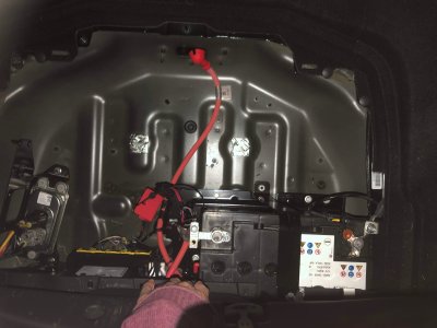

In the meantime, is there anything wrong with putting one clip on the positive battery terminal directly and the other on the negative stud?
Thanks!
