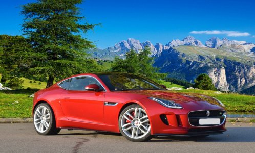

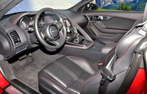

Hello
I am about to finally buy my dream car, an F-type R. I am from Sweden and the car is in Germany.
I have driven the V8 S way back in 2013 and V6 S but never an R. The car is a 2016 model year with AWD and only has 16000 km (9940 miles) on it with 1 owner.
But in general when I am there looking at the car I am about to buy what would you say are some things I must make sure are looking right?
Exterior wise and interior wise please. And if you have any other tips please feel free to advise me.
I am thinking I would make sure all electronic bits are working as they should etc.
The owner already sent me the VIN and I saw the service history was as it should be and the spec on Topix matched what was shown in the ad.

Brake disc condition, Rear sub frame braces for corrosion. Stone chips on bonnet front & bumper. Looks very nice in pics. At that mileage I doubt there will be any problems.

Look at the body panels and make sure they all align up. Especially the front panel matches the Bonnet and wheel arches. Mine was out. The garage has to reset. Jaguar said it was a common problem due to manufacture.
Check the spacing is equal between each panel. Some have a tendency to be too wide at one side and narrow at the other. No real issue. But one seen can’t be unseen.

Great, thanks. The ad has many photos and through what I’ve seen so far the car has very good body panel alignments.
Looks a beautiful car.

The F-Types have a known issue with the carpet pulling away from the center tunnel cover. It seems most dealerships are happy to warranty the problem, but it's definitely something to be on the lookout for.....
In the one photo you posted of the driver's side seating area, the carpet seems fine, though it appears to affect the passenger seating area more often for some strange reason.
