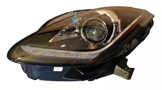

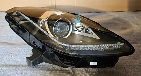

Have a read of this https://www.jaguarforums.com/forum/f-type-x152-72/adaptive-headlights-211438/ which includes...
"If you look at the headlights the AFS ones have an additional light on the inner side of the headlight unit."
and...
"you should be able to check if they are from topix or if you have the original supply build sheet for the vehicle."
Also, a Google search produced this...
"For Jaguar F-Type Bi-Xenon headlights, a simple replacement with a like-for-like unit usually does not require coding. However, the situation becomes more complex and coding is almost certainly required if you are changing the headlight technology or if the replacement unit has additional features, such as the Adaptive Front Lighting System (AFS)."
Headlamp parts info for your car is here...
https://parts.jaguarlandroverclassic.com/parts/index/part/id/152.1072.2417.11308/brand/jaguar/
I've attached two pics of the Bi-Xenon headlamps with AFS for you to compare with your own...
