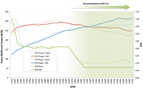

DaddyDarren said:
Thank you Tel. Could you explain the different curves please? Not sure what’s what 🙃
Apologies for chopping off the legend for the curves.
The following should be a little more explanatory and save my thumbs from lots of typing 😉
