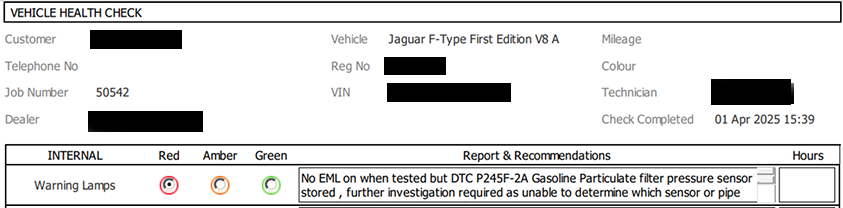

Following advice from the seller dealership, the vehicle was taken to an authorised Jaguar service centre on 01/04/25. Their diagnostic identified P245F-2A. See inspection notes.
Interestingly – this shows as “Diesel” Particulate Filter on other OBD scanners and web-searches…
The service team advised that further investigation is required, which will probably involve stripping down the engine to determine whether the fault lies with a sensor (there is 2) or a pipe. While the vehicle is covered under its Jaguar Approved Used Warranty, the earliest date for further diagnostic work is 09/04/25, and unfortunately, there was no courtesy car is available. Upon leaving the repairer dealership having confirmed the above date for diagnostic/repair, the “Limp Mode” issue occurred 3 more times on the journey back home.

What else was in the report?
There is a scroll bar which suggests there is more below.
Hope you get it sorted one way or another.
Yeah I noticed that too, but they never said...
One weird thing is that in both my own and the AA diagnostics scan: P245F-2A shows as a Diesel Particulate Sensor, yet the car (as we all know) is petrol.
I read a post on another forum that certain VIN numbers were affected by having the wrong sensor installed i.e. Diesel Particulate as opposed to its Petrol variant. My car falls outside of the VINs stated so God knows.
