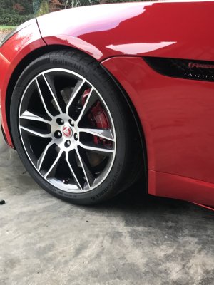

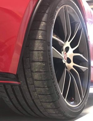

Continental SportContact 6 on mine upgraded to 305 rears 265 fronts, brilliant tyres no issues any conditions

My recently purchased V6S came with brand new Continental SportContact 6 tyres and I’m impressed with how quiet they are. Haven’t really tested them for grip yet.

Rears we’re done, so seen some posts on people going for this wider option, 265 is the match for 305 so did all 4, I’ve 15mm spacers all round and lowered on Eibach springs, seriously good grip on these tyres
