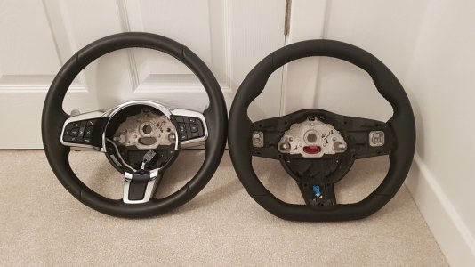

Folks, on my 2013 V8S the trim that sits around the horn/airbag shows some wear.
Whilst an easy part to replace I am struggling to find a decent price the part that fits a flat bottomed steering wheel (T2R24258) where the part that fits a round steering wheel (T2R19453) is easily found and for a Jaguar good value at £75-80.
Does anybody know if they are actually different? The trim doesn't go near the bottom of the wheel and whilst comparing mine to the images online (not particularly accurate I know) they look identical.
Will 100% fit. I swapped my trims from round to flat. See below.

oh goody I hope you are right, thanks for responding.
my buttons are sticky so have replaced and am looking to replace the upper and lower trims with gun metal rather than shiny. the car has a couple of black packs and shiny wouldn't work for me.
