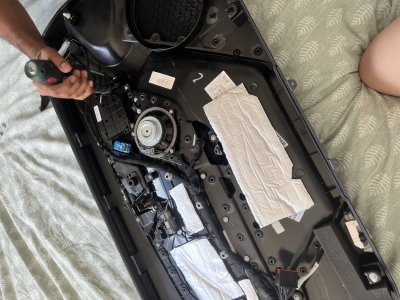

Hey folks, having a weird issue with my V6 F type 2014 coupe.
Comes with the base factory system, and there is a buzzing noise coming from the driver door at certain frequencies.
I thought this was the sound proofing issue so spent yesterday soundproofing the car and ensuring none of the wiring in the door was vibrating. The buzzing however still persists. It seems to be coming from around the middle speaker in the door, the one close to the grip on the door.
It changes as well, it’s not always present, but when it is it can be really horrible and reduces all music to a buzzing mess.

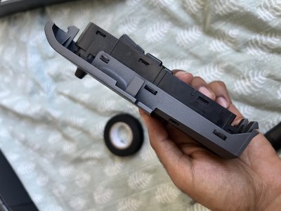

I did a lot more snooping today. I thought I’d give it a final go before giving up, my door panel had come gone on and come off about 10 times and felt like it needed some peace.
After a lot of investigation, I cornered the issue to the window switches. They rattled like crazy, and when I pressed down on it, the rattle stopped.
I removed the panel again, and there are about 10 T20 sockets that hold the handle/handrest and window switches to the door card. Removing these allowed me to take off the leather part of the handle, and gave me access to the window switches.
After removing the switch and unplugging the cable, I realised the entire thing was quite rattly. The outside housing rattled alot against the switches and electronics inside. I took off the housing, gave it all a clean, and put felt tape inside, to ensure a really tight fit.
There was also a little broken plastic tab in the middle of the housing that had to be removed. That could well have been the biggest cause.
Either way, added some extra sound proofing here and there, and when I put it together, it was gone! Finally.
