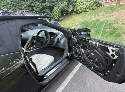

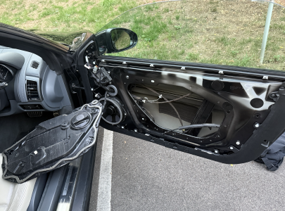

Trim panels off, torx screws out, and door card off. Door card for the first time was a bit daunting...top tip: gently lever some space and spot where the clips are, then put the trim tool close to one and apply pressure into the door (better than away from the door so as not to bend door card, and spreads pressure to pop door clips easier). I recommend starting top right above the door latch and working down. Once you've popped the first couple you get the hang of it. As per video unclip door handle release and door power.
Tip: take note of how the door handle release works. The video doesn't show it. It's clipped in two places: the top of the wire and the chunkier black plastic part. You'll need to re-attach it later. All very easy but take note...I didn't first time and the inner door handle didn't work. Ha. An easy fix but do it right first time and avoid re-taking the door card off like I had to...
Take the inner panel off with torx.

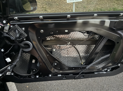

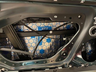

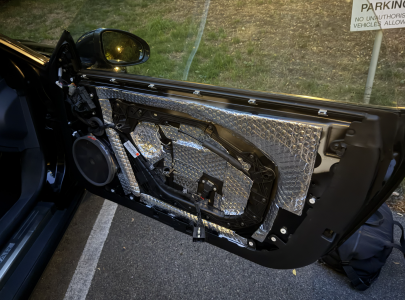

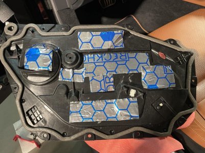

Get soundproofing! Good fun.
Reattach panel (thread door release and white cable back through) and keep on soundproofing. This is where I began to run out of soundproofing - I thought the inner was more important so prioritised there. As long as you leave space for door clips etc. you can probably add as much as you like.

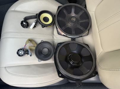

Speakers old (bottom) vs. new (top)

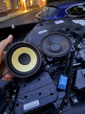

Swapping out the new mids with cool kevlar cones

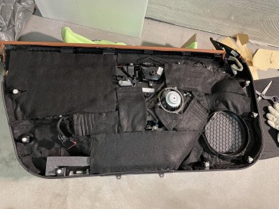

Inner and outer soundproofing done, and all new speakers installed. Ready for reassembly!
I found it pretty easy to do everything in reverse - door cards are pleasingly simple to slot back on. Make sure to 'seat' the door handle release properly as noted above. Slide the black tip of the wire inside the silver holding (easy), and also make sure you clip the chunky black plastic circular piece in to the door card holder.
