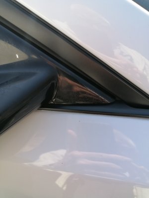

I've added some photos of areas I could do with comparing against others for your opinions. The glass on the doors seems to be sealed well. What do you think to the black triangular bits on the wing mirror base? Out of alignment or normal?

Right.... I've located the whistling phenomenon!
Pulling the drivers wing mirror in stops the noise. Put it fully out again and it starts.
It looks as per the pic above so don't know if it's somehow mounted incorrectly.
It's so annoying. I can't find anything obviously wrong with the mirror assembly, like a piece of plastic sticking out for example.

I have now located the issue!! It's definitely the wing mirror. 2 photos showing you where the wind noise comes from. If these are taped up or covered with your hand, zero noise. Now to figure out what to do to fix!

Just checked mine again and the gaps look pretty much identical to yours. Going to be difficult as it moves but maybe take the cover off and re-seat it?
Solved it. Took the door card off, removed wing mirror and reseated everything. The window trim had moved a few mm and could slide left and right. I've pushed it fully against the wing mirror area and put back together. No wind noise now !
