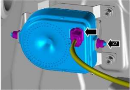

There must have been a fair amount of water pooling in that right-hand corner of your car to submerge the ‘battery back-up security sounder’. It’s attached up onto a bracket on the side of the bulkhead panel (TOPIx pic attached).
I’ve already checked the area for water or any debris (leaves etc) and all looks ok......will be keeping an eye on it now and again though! If I end up replacing the ‘sounder’ I’ll be able to see and access the drain/s better when I'm doing the job.
