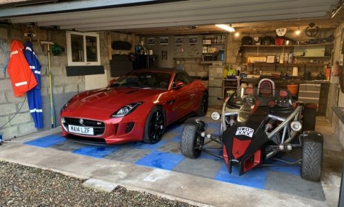

As an owner of an Ariel Atom, where there is no “good” place for a legal number plate, I have been through this many times! Most MOT stations are clueless and will pass a stick on number plate, but alas, if plod decides to go after you, they always win!
I regularly do a charity “supercar for kids” track day event where “friendly” petrolhead police come along. Speaking with them they admit they normally turn a blind eye as they don’t see the harm, but get the wrong one on a bad day and you face a fine and 7 days to get it rectified!
You pays your money and take the risk!

Thats interesting as I took the stick on number plate to my MOT tester and asked his advice on it's legality.
He said the cross beam (holder removed) is not big enough to support the full size lettering without bending it so the law says it has to be placed in the most vertical position on the front of the car and so the front of the bonnet is OK. I'm sure legally the police could fine me under the letter of the law but it is still pretty prominent and I'm not changing the size, font or reflective qualities, they'd have to have had a really bad day or for me to be doing something really stupid. Been on for a year now with no issues.
Yes, I think if you keep the spacing, font and spacing legal, 99% will turn a blind eye. One of my friends with a TVR Cerbra did that, but got fined as the a Policeman just seemed to have it in for him....he had, had the same stick on number plate for almost 10 years with no issue, but maybe his straight through exhaust didn’t help!!!

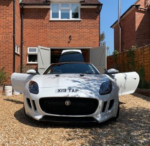

Hello Dan,
The price is correct for the OEM Project 7 Grill/Surround.
Regarding sensor pockets, I did not want them fitting to my grill. It’s a lottery whether they work or not & rather have the clean look. On my car the two middle sensors have been secured behind the grill out of vision. I effectively only have the rear camera to assist parking now. This is fine for me as car only driven to meets & pleasure drives. Always reverse into parking spots, if necessary & I’ve been driving long enough to trust my distances 😄 If you insist on fitting them there is a template on the US forum.
A good body shop could easily turn a ‘bumper bar’ grill into a one piece surround. You would then need the inner grill, again easily obtained plastic grill mesh. I’d seriously consider this option if I did this again.
Regarding the plate...
This is a correct reflective one with legal lettering & spacing. Been through two MOT’s at Jaguar main dealer with no issues. I’m sure police more interested in the dodgy spaced ones, smoked, made smaller etc.

Looks great DaddyDarren - it makes the frontend look so much more aggressive.
