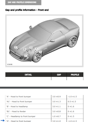

I've had a repair, new bumper nicely done, but the gap between the front of the bonnet and the corresponding edge of the bumper top is 6mm and looks a bit large. Larger than it used to be. When I mentioned it, the body shop said they'd adjust it next week, (but they obviously thought it was OK). So my question is - what would be a sensible gap to aim for? What do you have?
