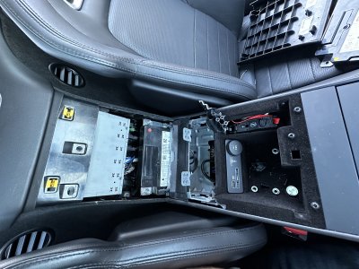

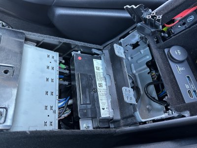

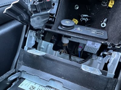

-low life who stole the car ripped the armrest out, assuming he messed around with some of the modules
-the key seems to be fully bricked, car doesn’t turn on unless the key is held by the steering wheel, can’t lock or unlock the car with the key nor use any of its functions, basically none of the buttons do anything.

Mechanicals seems to be fine, due to go to a garage soon for a check up. I’ve attached photos here, main parts I need help/advise with are the faults and what could have possibly happened to the modules underneath the armrest and the key situation (I’m guessing a module of some sort messed with when stolen). The trim behind the seat was taken off too so not sure if another module there too I need to be mindful of.

First thing I’d want to do is hook up to a code reader and see exactly what errors it’s throwing. That will be key to diagnosis. Carsoft is a good basic tool.
Second I’d look at all the modules to see if they have been touched. You may see marks in dust that show what’s been touched and tampered with.

I connected OBD reader yesterday but surprisingly didn’t return any fault codes, I put it to the reader being ancient, on my list to order a new more high spec reader to see what it returns.
Difficult to say what modules been touched, it’s gone through police/insurance/place I bought it from. First and main guess was they ripped the armrest to get to the telematic module to disable it as that’s what talks and makes the car visible online to minimise chances of it being tracked. Another thing I just discovered is that the SIM card reader doesn’t hold the SIM card in, usually when you push the SIM card in there is a little click and then to release you push back in but this one sim just slots in and out (could be another item for the list of to dos). I’m hoping for someone here to know what else could’ve been of interest underneath the armrest/behind the seat that they may have messed about with - potentially whatever that has bricked both keys.

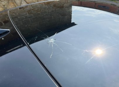

Glass roof crack seems to be from an impact, maybe large stone or something. Photo attached.
Panel gaps seem okay other than from bumper and bonnet where the impact was.

Roof looks like an impact by stone, etc. ,or just malicious, so I’d not consider it crash related.

The only thing of interest in the centre console would be the TCM (Telematics Control Module) and possibly an antenna but there are a few of these dotted around the car. The KVM is on the A pillar
