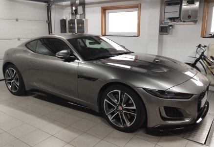

And I posted already a picture of my car in the F-type gallery page ;) . Because it was mostly raining the last 2 months, I didn't had the chance to take nice pictures so I took one of it parked in my garage :-). (My hobby cars may not drive in bad weather ).
