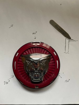

Hi Barry,
thank you for the great write up. I have just "upgraded" the front growler to an all-black 100mm one.
The front bumper or even the radiator cover need not be removed.
The way i did it was to carefully remove the outer bezel [where jaguar is stamped].
This gives access to the main part of the badge, which has an inward chamfer to it.
The tabs are located in the 000, 120 & 240 deg position [clock face i=12, midway between 4&5 and 7&8].
There is enough room to push the tab down following the chamfer - i used metal shirt collar stiffeners, and once released it just pops out.
Save your fingers next time......

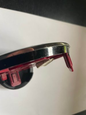

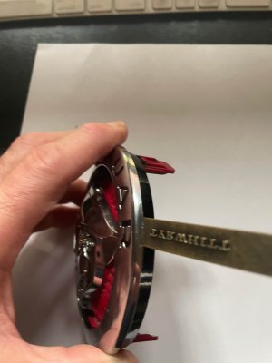

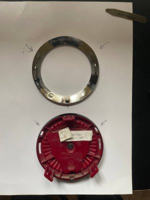

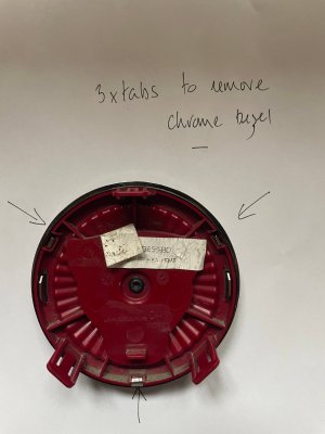

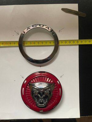

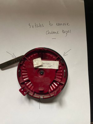

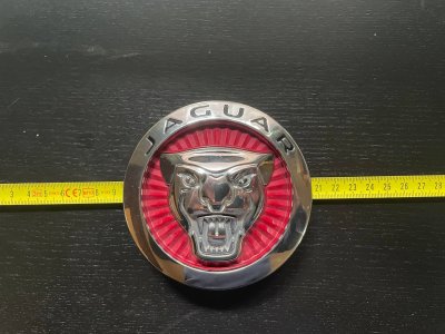

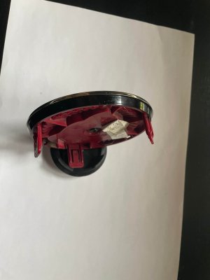

Hi Barry,
My wagon is a MY21 facelift... I checked with the supplier [Hermann in Germany] that the part was for the new version, which was confirmed.
The one i have is splitable into 3, chrome bezel, red insert with black surround fused on and the growler head held by a single screw.
Its identical to the all-black that i got, using your part number. The all-black also splits into 3 thats how i worked out how to remove without all the aggro that you went through [also my fingers didnt fit that well!!].
I have added the pictures showing the process...
Cheers
David
EDIT - the pictures have loaded in reverse order, so start at the bottom and work upwards!!!

DavidP said:
Hi Barry,
Cheers
David

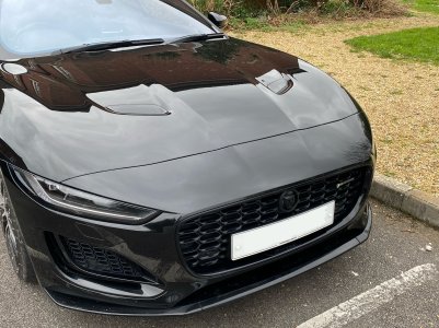

Finally got round to doing mine... appreciate everyone's supportive words but I did not find this easy at all! My fat fingers and ineptitude resulted in me drilling out the brackets off the original badge :lol:
Was touch and go but looks good now! Glad it's done. Opted for the 2023 black R badge too. Luckily that's just a sticker.
