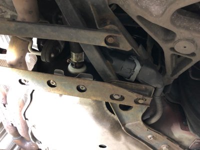

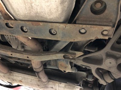

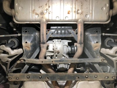

Had mine replaced under warranty in March, this was the condition of them on a 2016 Car with 20k, I also bought a tin of black Hammerite paint and got the dealer to give the new parts a coat just to be sure...

That is almost the same as mine was, and mine is stored over the winter, so anyone driving in salty winter road conditions😮.
