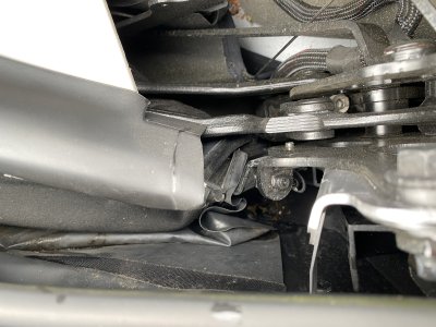

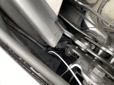

For anyone still following along, the news is good!
Both the drivers and passengers side drains are now clear. The specialist just ended up blowing compressed air down it.
He explained where the drains are, so now that I'm back I've had a good look myself to see if these are easy to get to for routine maintenance.
You have to put the hood down to just over half way to see them. Although only one of mine were blocked, there was quite a lot of sediment and dirt around the drain entrances, so I can see how these could easily get blocked.
It's a bit of a squeeze to get your hand in there, and probably best to make sure no-one is inside playing with the buttons, but not too difficult to scrape out some of the crap.
I've (hopefully) attached a couple of pictures showing where the drain holes are. The white thing is a bit of 3d printer filament shoved in the hole so it can be seen more clearly.
If you have a convertible with these drains, I think it should probably something you have a look at from time to time before they do get blocked and possibly cause more serious issues.
I'll certainly be keeping an eye on mine from now on!

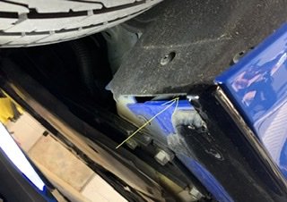

Thanks for the update, very useful.
I’ve been underneath mine and couldn’t see anything!
Just put some water down from the top to see where it comes out, just behind the front of the wheel arch liner, no wonder I couldn’t see anything from below!
Your's looks a little different to mine below, but as long as you get some water coming out on each side you should be free from blockages!
