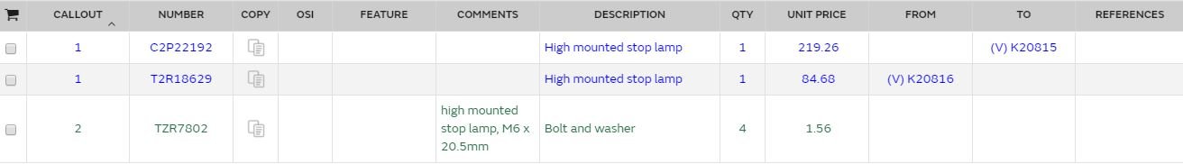

Today I contacted Sturgess and Guy Salmon and was informed the part number is T2R18629
Interestingly Sturgess quoted £98.65 inc vat and Guy Salmon £101.62 inc vat for the same part, not much in it but I thought JLR parts prices would be the same?
In the mean time it’s dried out again so I’m in no rush to replace it just yet,

Jagman100 said:
Thanks everyone, just a quick update,
Cost I have seen. Is the same as the prices below are excluding VAT.
Thanks yes that makes Guy Salmon price correct but Sturgess was a different price, I think they made a mistake, but like I said not much in it.
It’s dried out for now and it all lights up correctly so I’ll leave it for a while before I change the unit.
