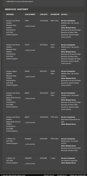

Thinking of viewing this car as it has most of the specs I'd like, it is a MY19 V6 380.
I've so far looked at the service history (VIN was in their photos and I think I copied it correctly).
My main thought is lots of details on what was done but doesn't mention rear diff oil so I'll ask about that, anything else obvious from the below?

Screenshot of the service history from the vin is:

It should have been done at three years, also no mention of brake fluid change but owner may have passed on that element and had it done elsewhere or maybe just tested themselves and considered not required? MOT history is fine, bar a failure for a wiper blade. It’s not done heavy miles if going ahead would get it done now.
Yes you have the original plate correct.
Yes it is car 60395 MY19 spec.
The service history is missing rear diff oil at 4 years and spark plugs at 5 years.
MHA to MHX was a batch of Corris Grey in various P300, V6 and V8 guises. This was ran by C Walton so would of been used for something Jaguar or fleet related, serviced by fleet provide and then they go to closed BCA private JLR auction with a description which includes any repairs and one of three categories.
1) Ex Corporate Repurchase
A Jaguar/Land Rover vehicle previously owned by a vehicle rental company or allocated to a fleet available to JLR partners.
Possible multiple users.
2) Ex Jaguar Internal Fleet
A Jaguar/Land Rover vehicle previously allocated to a fleet available to JLR customers and partners.
3) Ex Jaguar Management
A Jaguar/Land Rover vehicle previously allocated to an individual employee.
This is the gap between the fleet provider doing the first service and the new/used prep for sale. Cannot find any trace of who had it or used it first.

FYI, I decided against that one, the potential for misuse early on combined with the lack of evidence on rear diff oil change meant there was a risk of damage (I called them and they said it would have been done if due, honest,
but had no evidence !), plus my lack of knowledge means I might not have noticed during warranty period. So currently saying no.

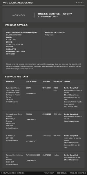

On getting home I checked the service history of the v8 (OV20 VFO) using the vin and got some concern, so questions are:
1) He said it still has a Jag warranty as the previous owner took out a 5 year warranty. Do I need to phone Jag to check if that is true?
2) The v5 said 1 previous owner, but my search shows it was PDId by Paragon Fleet solutions, then serviced by C Walton. From what I've read of SimpleR posts it seems Paragon isn't always bad but then going to C Walton means it may have been track day?? Am I correct of that red flag? (I've also found the reg on a car bloggers site)
3) When asking about rear diff oil change, the dealer said the rear diff was changed under warranty, I can't see it in the service record below but is there another way of checking that? (Note that the below says 1 service missing but I saw a paper copy of the most recent service).

I would personally avoid any cars that have come through JLR “ex management” or “fleet” or “corporate” my experience is with “ex management” and experience was not good I’m sure some “ex management” are great cars but 🤷🏻‍♂️
C Walton doesn’t mean track day ( see explanation from SimpleR on this thread) could be “ex management” from what I seen “ex management” is effectively a car leased to a Jaguar employee it can then be used by family members etc.
on the warranty I think Jaguar extends a year at a time after 3 years, Jaguar offer 2 warranties limited or full cover, or the warranty maybe an aftermarket one warrantywise or the like

OV20 VF was a batch of Jaguar cars used for various events.
OV20VFO was a test car used by magazines, this one was loaned to mens health blog and magazine and associates.
https://www.carlthompson.co.uk/further-reading-blogs/2020/12/21/2020-jaguar-f-type-p450-oh-shes-your-type-shes-every-mans-type
Thanks again, I loved the colour of that one but in reality I would worry that I wouldn't notice if it had been previously mistreated until too late.

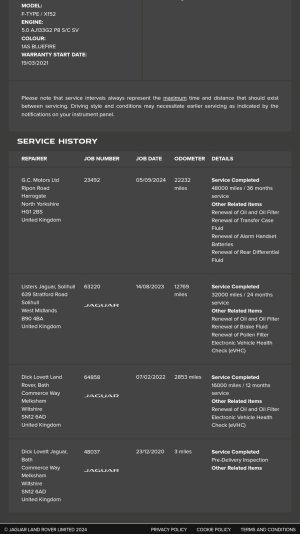

I think I've found a good one this time so interested to hear thoughts. Having previously tested the p450 I fell in love and realised I had to dig further into my wallet.
Reg WM21 AUE. I plan on test driving this weekend.
It failed its last MOT due to a bulge on the rear tyre which was then replaced - I've checked and no damage to the wheel so hopefully just a glance of the tyre.
Service history below, all items seem to have been done. 2nd and therefore 3rd year services were late (now 6 months behind) but the rear diff oil was done at year 3 instead of year 4 so at least that isn't late.
I'm assuming the 3 month delay between pdi and warranty start was just it sat on forecourt prior to selling?
