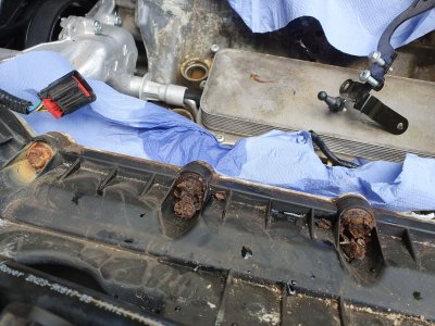

Speaking of corroded and snapped bolts on the F-Type, have a look at the state of what this member found..... https://www.ftypeforums.co.uk/viewtopic.php?p=44684#p44684

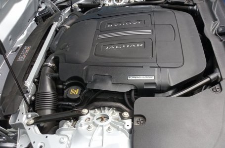

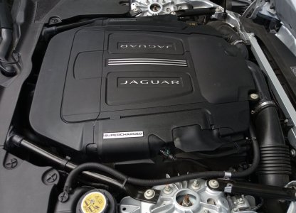

Here whats I've done to stop water getting onto the heads and in the vee, Have used EPDM roofing rubber sheet bonded to the underside of the engine cover to deflect water away from the heads, also re-routed the coolant bleed hose as the water was tracking down this and finding its way onto the top edge of the rocker cover.
Nice preventative work on your modified engine top cover 👍
Similar to what I did here....https://www.ftypeforums.co.uk/viewtopic.php?p=59388#p59388
That looks the neatest solution I’ve seen.
What did you use to bond the sheet to the cover ?
Is it holding up ok ?
Just bog standard superglue. It's not a whole sheet going all the way under the cover, just a few small pieces around the edges.
It's holding up just fine.

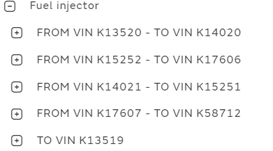

If you're after the injector part numbers they're all on the excellent JLR Classic website here..... https://parts.jaguarlandroverclassic.com/parts/index/hierarchy/id/C72.C7219.C7219240/brand/jaguar/
The same site as where jonm took the screenshot from ;)
Thanks RPSN.
So taking the V6 and in numerical order, there are 5 groups of VIN numbers and the respective number of injector revisions are 4,3,2,3,2 - quite a few then!
However, there are only 2 latest injector part numbers…
C2D55169 up to K15251.
C2D55182 after that.
Not sure how the 2 different current parts relate to any model year or other technical reason.
Thanks both, good to know no issues with either of your cars. You’re right that nobody generally posts to say everything’s fine! I’ve got a years warranty from the garage it came from so if I get any surprises in the next 11 months I should be covered, and now I know where to try if the injectors do get stuck rather than paying through the nose for new engine parts!
Thanks for the tip RE not being able to see anything as well, I’ll not go poking about in the engine bay at the weekend - apart from with some tape to cover the edges.
My car is also not garaged, though it sounds like the previous owner kept it in a nice heated garage so hopefully that’s helped with general condition since build, but unfortunately for the new few years she’s going to be exposed to North West rain outside my house so I’ll take extra care to look out for issues.
I’ve always used Shell V-Power in both my cars (previous car needed minimum 98 octane and I have an old Toyota MR2 that can’t cope with E10) so I’ll be carrying that on with the Jag - hopefully I don’t have any injector issues so no reason to ever find out if they seize.
I’ll have a look at my VIN later this week and check vs the list of injectors as well; you’d assume/hope that each different injector was an improvement.
Lunar said:
Thanks RPSN.
Yes, like many other parts on the JLR Classic website, there are several VIN number ranges with applicable part numbers. As you point out, there are two latest injector part numbers for the 3.0L V6. The part numbers are VIN specific.
For early models, the latest fuel injector part number is C2D55169
For later models, the latest fuel injector part number is C2D55182
I’ve put them into context here....
TO VIN K13519 (C2D55169)
FROM VIN K13520 - TO VIN K14020 (C2D55169)
FROM VIN K14021 - TO VIN K15251 (C2D55169)
FROM VIN K15252 - TO VIN K17606 (C2D55182)
FROM VIN K17607 - TO VIN K58712 (C2D55182)

I’m still using black 50mm Duck tape over the cut-outs/gaps on my engine cover with no issues. I’ve replaced some of it since I first applied it just over 2 years ago.
