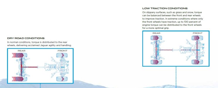

Jaguar clearly went the AWD route such that for the vast majority of times the car behaves as RWD, only shifting power around when slipping is detected. Maintains the right handling, balance, performance and fuel economy.
