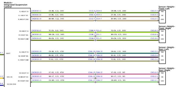

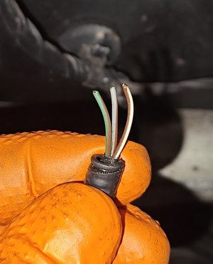

Hi all i have 2016 f type 3.0 s awd, after little incident I've lost left front left height sensor plug and now I don't know which wire is which. I have 3 wires and new aftermarket plug with different colour wires and I havent got a clue how to wire it.
my wires are as follows can you take a picture of your please or please help me find a diagram how they supose to into go in the plug please.
