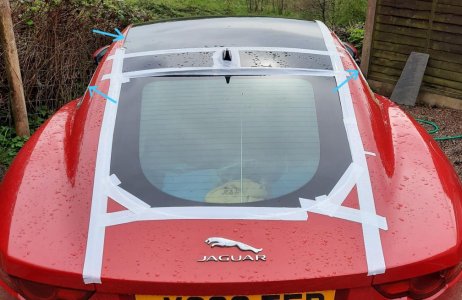

Next I decided to apply tape to joint area between tailgate and ROS panel, then between the roof and tailgate etc ...to seal those joints in a process of elimination ... and got nowhere. It still leaked (with the parcel shelf removed I was able to pass pieces of blue 'test papers' over and between vehicle seats and place them in 'drip spot X'). I eventually ended up with every joint/seam covered, and it still dripped (we've had plenty of rain to do tests eh!). So I changed tape to gaffer tape ...and it's still leaking (see first picture).

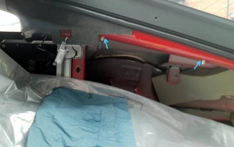

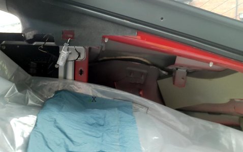

As it can be difficult to trace where these water leaks are coming from, I’d start by sealing the clip above the drip area marked ‘X’ in your pic (below) and also the other clips along the underside of that tailgate channel (check if there's one under the C-Pillar trim). Before doing so, press down on the plastic/rubber ‘U’ channel to ensure the clips are fully inserted. This will be easier than removing it and sealing the clips from above.
You need a good sealant and I can highly recommend 'CT1 Sealant & Construction Adhesive' which also seals underwater. I have it in black which comes in very handy for numerous jobs on my cars and around the house. It takes up to 72 hours to fully cure depending on conditions...
https://www.ct1.com/our-products/ct1/
https://www.toolstation.com/ct1-adhesive-sealant/p21735
After you've sealed those clips test again to see if the leaking has stopped.
In your process of elimination, you could also try taping over the roof channel on the nearside (LH) as you've already done it on the offside (RH). Also the chrome trim (window finisher) on both sides of the car as marked in the pic below. If the leak still occurs after doing that perhaps the gaffer tape you have used to seal the gaps is allowing water in?

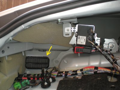

With regards to the boot ventilation outlets that I mentioned earlier which are located in the rear quarter panel lower extension, TOPIx states there is one each side but I’ve yet to see a pic of one from the offside (RH). Being as you’ve removed the offside boot trim side panel would you be able to provide one after you've finished testing for the leak and the tape has been removed? I've attached a pic of mine from the nearside (LH).

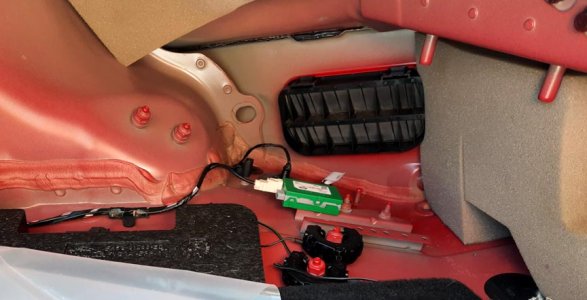

Below is a photo of my O/S vent grill (I think that's what you requested).

Many thanks for the photo of your Coupe offside boot ventilation outlet. This confirms the TOPIx info I have which says there is one each side (nearside and offside).

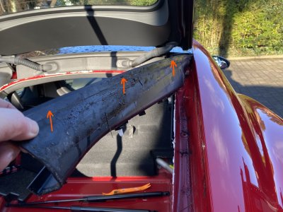

The ‘U’ shaped plastic/rubber channel can be removed by pulling it away from where it’s sealed against the side of the bodywork as I’ve shown on Gareth’s pic here https://www.ftypeforums.co.uk/viewtopic.php?p=50821#p50821 and then lifting/pulling it up from the channel where the clips are (do not hammer the clips). However, as you've previously said that you don't fancy doing this, you should be able to fix the leak by sealing the clips from below as I've explained to you in this thread.
You've done all the difficult work of removing the boot interior trim panels and tracing the leak so you're almost there now :)

Thanks RPSN, I think I definitely will remove the channel as, as you rightly say, I've done all the difficult work already. I've seen above post (thank you Gareth) but wondered if the clips are best dislodged (pushed up) from underneath so as to free the channel up, or ..... clips are pulled out/up by firstly lifting the channel. The clips seem to be hard material and very firmly in place, and my concern has always been not to damage the soft material of the channel. Maybe they come out much easier by pulling them out/up from above (rather than attempting to push them out from below).
You don’t really need to remove the ‘U’ shaped plastic/rubber channel to fix the leak unless you’d prefer to. If so, remember that the tailgate strut also needs to be removed at the lower end only (where it connects to the bodywork). Before doing this, ensure you support the open tailgate as explained here... https://www.ftypeforums.co.uk/viewtopic.php?p=50821#p50821
You should then be able to pull the channel out without causing any damage to it (even if it takes a bit of force) after releasing it from where it’s sealed against the side of the bodywork. When pulling it out, start from as close to the clips as possible. If it still doesn't budge there’s no harm in giving the clips a push from underneath to see if it helps. If you break any then refer to this thread.... https://www.ftypeforums.co.uk/viewtopic.php?p=80301#p80301
