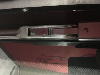

There's no need to 'yank' anything when changing the wiper blades.
The job is easily done when the wipers are in the parked position by releasing the securing tabs with a small flat-blade screwdriver etc.
As described by member JohnGB in this link https://www.ftypeforums.co.uk/viewtopic.php?f=21&t=1303.........
“Done it.
“The black tab is indeed the key to it all.”
“The tab is quite a tight fit but reasonably robust. By inserting a screwdriver blade between the tab and the wiper arm hook, then gently but firmly levering the tab, it pops up and the wiper blade can then be removed in the usual fashion.”
Indeed, exactly how I did mine.
Yep, that's the way to do it.
