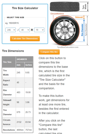

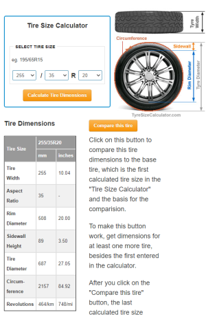

Good to know that there’s extra ground clearance with the 20” wheels and tyres.........this should mean less scraping of the front bumper lower air deflector!
I’ve attached two screenshots showing details of the front 245/40 R19 and 255/35 R20 tyres. This shows tyre width, rim diameter, sidewall height, tyre diameter and circumference etc.
