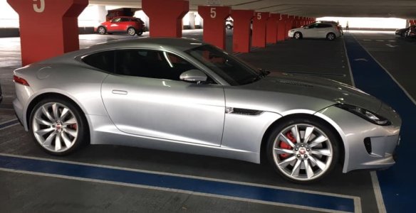

I'm having second thoughts about the diamond cut 'Gyrodynes' after seeing these beauties on the same F-Type model and colour as my own.
In my opinion these powder coated 'Turbine' wheels look amazing on this car!

I'm really happy with the 20" Turbines - I think they have a really nice flow to their form, which compliments the F-Type's design.
Do get them Gtechniq or similar coated as you'll be spending a lot of your life cleaning the brake dust off :D

I bet you are.......those powder coated 20" Turbine wheels look the business!
