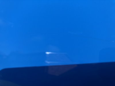

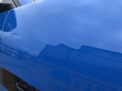

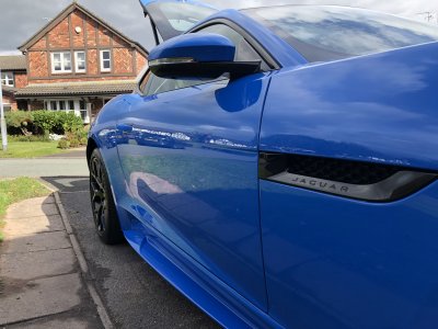

Hard to get photos outside in sunlight which showed the scratch just using my phone, but you can see it if you zoom in - here is the scratch (the dark wavy line), then after applying clear (which you can clearly see looks a mess!), and then the wing once sanded/ polished and waxed.
