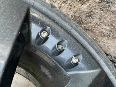

After having my wheels refurbished, I’ve found one of the titanium torx screws has gone missing!

I would check that the stud wasn’t sheared off. Common issue that on allows they corrode and shear when restoring.
Used to happen all the time on Z4’s
Some were sold with sheared head of studs glued or attracted a £50 drill out charge
Yes it has sheared. I can see the tail in the hole. I can extract it, but still need a new screw.
I’m a bit peeved the restorer didn’t say anything! Also had a tyre valve leak causing a pressure warning. The washer on the valve sensor was trapped.
No luck with scrap wheel. So drilled out the broken tail. Carefully with progressive drills starting with 3mm up to 6mm.
Got a few BBS screws from eBay that are just about the same as the Jaguar items.
Now waiting on a 7mm tap to clear the threads out.

Hi Gareth
Just about to have my alloys restored but the company want me to remove the torx screws before (they don’t want the responsibility which I understand). Have tried a size 40 but it doesn’t fit perfectly and shears the points. Any suggestions for the correct tool?

Geoff,
They are not standard Torx which typically has 6 points and using such will just damage the heads. You need a 12 point star bit.
Something like this should do, or you'll likely find something in any of the larger autoparts stores or Halfords Pro range:
https://www.ebay.co.uk/itm/235848955595?_skw=12+poin+t+star+drive&itmmeta=01JN6DPHQMQNPRWK47PGXC2Y1J&hash=item36e9b176cb:g:R3EAAOSwHdpnSKws&itmprp=enc%3AAQAKAAAA8FkggFvd1GGDu0w3yXCmi1cG%2BEJYvJF3Am34d%2FjbFTG%2BXuRWWGbfNKeeWwtVx4IeGhv%2BFvEH7j5bL%2BBP98nFCR%2BR1GXV%2Fn%2BMJ4s%2BQg9ZM1kzhny9FPlrde5A1ewg%2FPv9S9FEApVfKPijNeyWEwom6Hrii4upSgmkHn4teFa7Zb%2B0WRW1UykdN9LEE21eZLyog6gSvk7r4W%2FbxnSl%2BXI1TvtglLj0U3aNtXpEX9k837sUSXEZZWCUW%2B%2FdSuCxbFdghHhCK5CXRu6gfe9wvVhZg07oA0CwdKaOVtC8xWslORc1s9jk3GDopn4Mcxjz7o95Hw%3D%3D%7Ctkp%3ABk9SR8Cd2s2pZQ
I've remove many over the years on BMW's often from BBS wheels and it's easy enough if you use a good quality bit and something like a T bar so you apply level and even force. Usually 1 or 2 stick and may even shear off without care, hence why refurb companies sometimes shy away.
