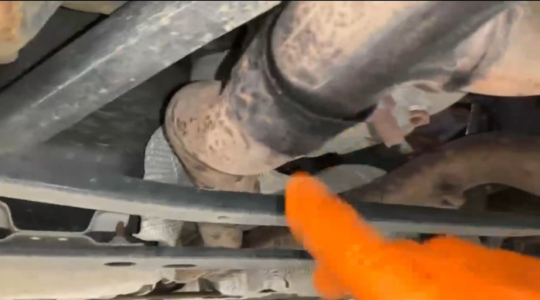

The exhaust 'raspy' sound wasn't diagnosed properly either and on the technician video also costing me a further £125 for investigation, it was claimed that the box joints were the culprit of the noise - to be honest, they were black as expected, but you could see some cracks/flaking on the joint with missing bits.

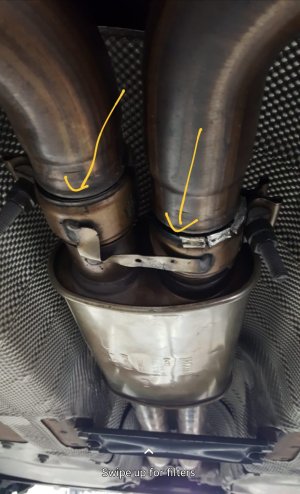

However, they currently insist I have the back box completely replaced again, with me having to pay upwards of £2.3k for fitting and the part (JT2R47475). I find this extremely disgusting, considering the car hasn't done more than 1k miles since 2019 - so why should I have to accept such a cost. However, I don't believe this should be the part replacing? - Could anyone, by looking at the picture, determine if there's a more cost effective way of repairing this - considering this also might not even resolve the issue.

I've used a guy in Leeds to replace my squeaky exhaust valves bug yours looks like its just a clamp that's needed.
I had a similar rasping issue, typically at 1500 to 1700rpm
I had the midpipe welded to the downpipe
Problem went away
There is no other fix, the clasp securing can't be tightened any further, this allowed free play of the pipe which caused the rasping
