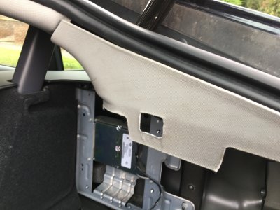

Hi I am going to change the drip trim as some lowlife damaged it a while back.
Itried a repair but I am not happy with it.
Looks like they tried to prise the window with a bar bent the trim and broke the glass.
I have a good idea now what to do but I am unsure where the rear bolt that fixes it, comes inside the car.
To avoid stripping lots of bits I wondered if anyone had seen it while removing boot trim
Picture attached. Thanks.

Hi I got in the boot and looked through the grill and can see it.
I do have a long reach socket but the bolt is just that bit too long for the socket to fit the nut.
I have ordered hopefully some longer sockets otherwise I will remove the trim I have a PDF from on here how to do it.

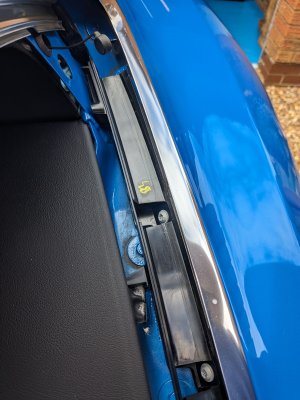

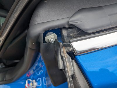

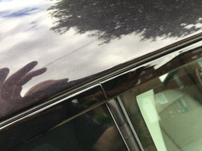

For those who are interested, I did this at the weekend.
Pretty straightforward, I had to remove the boot trim to undo the nut on the M6 stud (FYI long reach 1/4" sockets are not long enough, had to use a 10mm box spanner. Take a couple of photos of how the 1/4 window seals fit for ref before removal, and the position of the shims ( If fitted) under the 1st screw, closest the door aperture.

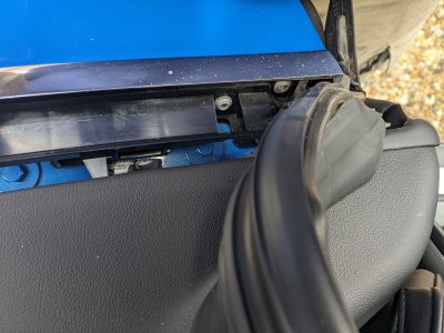

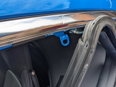

Hi all stripped and ready to go tomorrow. I have a couple more questions do I need to remove this trim near the airbag.
On the video the guy pops a clip on the outer trim, did you come across this. Thanks for your help.

Hi,
No need to remove the trim part covering the airbag, just the small semi circular rubberised trim part covering the glass lateral jacking screw and the DAB aerial connection. There are 2 small clips that locate the window trim, one shown in the video just above the B post, and one at the very front (Behind the mirror) - They are both small. And unclip with minimum effort ( I left the TX screws in and loose thinking I was going to struggle to get them to unclip, and didn't want the window trim "Swinging" around damaging paint - really not necessary)
