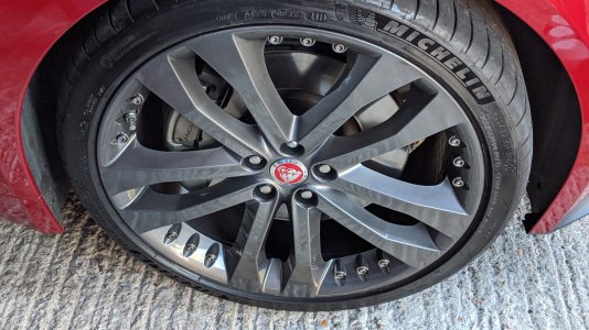

For anyone wondering. This is what it looks like with black bolts. Ignore the dirty alloys. Looked much better when freshly refurbed. Much prefer it personally. Have removed the other side and spray painted them myself, but yet to reinstall them

You need to sort out your centre cap alignment - growler chin to valve, please! ;)
Haha yes it's on the list once the torrential rain stops. I blame the alloy people for not putting them back properly :P
