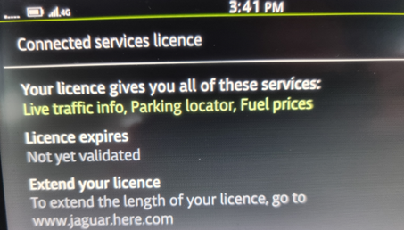

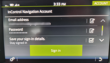

Since purchasing the car 2017 V6 R-Dynamic AWD (MY18) last year, I have never been able to successfully activate and link a here maps account to my online profile from within the car.

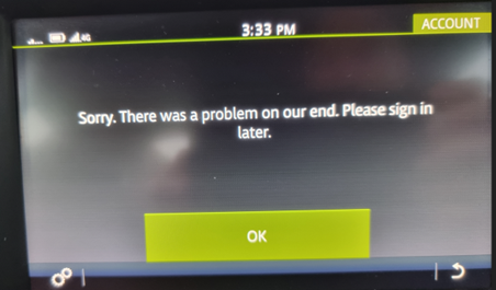

Every time I try to complete the registration process from within the car, I always receive the error msg:
“Sorry. There was a problem at our end. Please sign in later.”
Having left a Jag dealer earlier today to book my annual service, I mentioned this and they said "are you sure you registered the SIM card properly?"
My scenario:
Got a 24Gb for 24m 3 Data SIM
Car registered the SIM OK and have the 4G symbol
Have enabled Data Roaming
Can share its Data with other devices within the car and the car accurately records its usage.
Can update Headunit (8" Touch Pro) software via OTA where applicable (not sure if this uses the 3 SIM or not)
I have valid licenses and accounts for InControl Remote as well as jaguar.here etc but I still cannot get passed the initial Car log in screen
My online jaguar.here account lets me add my VIN, but trying to complete the link between online account and car simply does not work and the Jaguar Route Planner app confirms this by saying "No vehicle found"... sign in via your car..... argh!
I have read that a few people have successfully solved this by replacing broken parts or teh SIM itself, but mine definitely works (at least in the conecxt of providing data to other devies in the car) - so the SIM and its reader is good. I also read that someone else managed to fix their issue by connecting the car to their hosue WiFi. Unfortuantely that is not an option presented to me within my connectivity settings menu.
I'm soooo close to purchasing a laptop and mongoose or VCX SE reader along with some hooky Pathfinder software and then no doubt coming back here to cry that I bricked my car - haha
Sure it can't be this hard?
