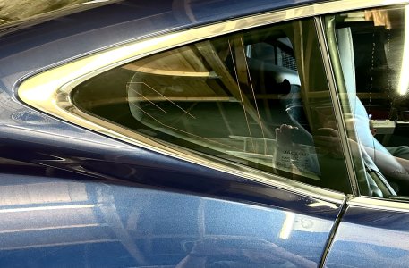

I've created this topic due to a discussion which started after seeing photo/s of the coupe rear quarter glass here https://www.ftypeforums.co.uk/viewtopic.php?p=90981#p90981
Taken from TOPIx...
“TV Antennas – Coupe
There are four TV antennas in the Coupe version. TV1 and TV2 antennas are located on the front windshield, TV3 and TV4 antennas are on the rear right and rear left quarter window glasses, respectively.
Digital Radio – Coupe
Note: TV and DAB are a mutually exclusive option on this vehicle.
DAB Band3 antenna and amplifier placement uses the left hand rear quarter glass.”
Regarding TV in the F-Type I found this https://www.ownerinfo.jaguar.com/document/2R/2016/1390576/proc/G1704440/G1703626
Also, the TV tuner module is shown on the parts website here https://parts.jaguarlandroverclassic.com/parts/index/part/id/152.1082.2487.11603/brand/jaguar/
I haven't yet seen an F-Type with the TV option so perhaps it's for Brazil and Japan markets as shown in the parts link above?
