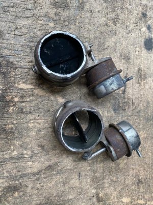

Similar to what was done in the link I posted earlier https://www.ftypeforums.co.uk/viewtopic.php?f=21&t=4635
"After being advised by various dealers/jag specialists a new replacement back box was the only course, I contacted a local custom exhaust company to discuss alternatives. The reason for this was because I could not move the shaft for the butterfly valve and coat it in any type of lubricant. I also hoped for a much more sensible solution."
"We decided to replace both the actuators completely in a job that cost 1/5 the price of a new back box and took 4 hours to complete."
"It was invaluable in helping me to find a solution and there is an alternative solution to just bolting on a new back box!"
"The company who did the works are http://www.stainless-exhaust.com/"

This exhaust job wasn’t done on my car but it goes to show that if the valves fail in this way, a new back box isn’t always needed 👍
