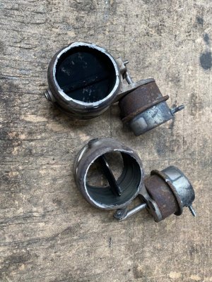

The attached photo is from one of the links and it gives you an idea of the internal and external mechanism of the active exhaust valves.

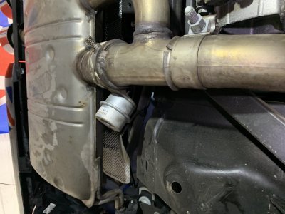

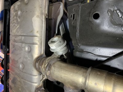

Certainly worth trying - I use a copper grease spray and also aim some down the actuator shaft, so it also has chance to drip through onto the butterfly spindle. If you wanted to really give it a chance you could jack each rear side up for 10 mins. and let gravity assist too. Can't remember which direction the arm pushes but pretty sure it's in line with the axle so you'd soon see which one to spray each time.
On the V6 they are angled up towards the middle of the car.
Photos taken from underneath looking towards the rear of the car.
