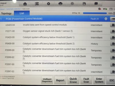

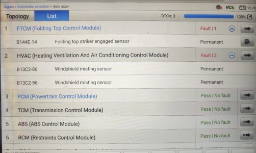

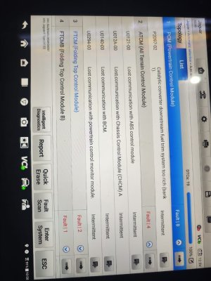

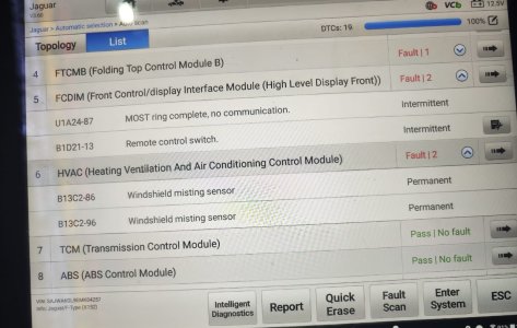

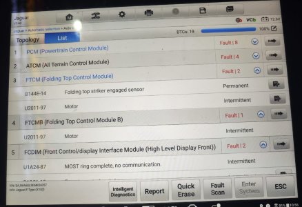

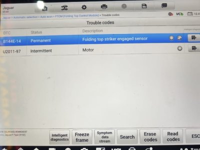

Pic shows error codes

That's a lot of possibly unconnected codes.
