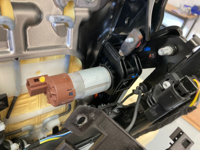

After having a look at the seats he concluded they did need additional work around the harness, but also found the motor for the cushion tilt present but without harness. Once connected, the adjustment became 8 way instead of 6 way (lumber aside) , and as it was demonstrated, the switches fitted to vehicles with 6 way seats actually have 8 way adjustable switches.
If you have 6 way adjustable seats, have a look underneath, if they have the motor shown in the picture they can be activated to 8 way.
If you don't have heated seats and want to fit them, you will need a harness fitting.
The other thing identified was that the seats didn't have any lumber support. The wiring loom you'd expect to see coming from the bladder and motor wasn't there.
