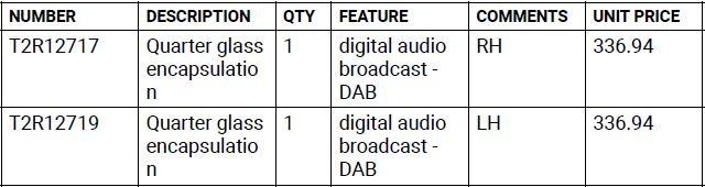

Dab maybe linked with the Quarter light glass. See the feature note on the Part numbers and the cost?
Yes, DAB does seem to be linked with the rear quarter light glass. Have a look at this......
https://www.jaguarforums.com/forum/f-type-x152-72/adding-dab-digital-radio-232279/
Note that it says.....“I'm adding DAB digital radio to my 2016 Jaguar F-type coupe V6. It is equipped with the NLI HU HARMAN BE L003 (so without the DAB: AM + FM), and I will replace it with the NLI HU HARMAN BE L004 (AM + FM + DAB). I'm not going to connect the L-Band connected to the shark antenna, but only the III-band. A Band-III antenna amplifier is to be added, and allows connection to the antenna which is located on the rear left window.”
I did have my windows tinted fairly recently after I got the car, I wonder if that makes any difference. I can't really remember listening to the radio before that so not sure if it was okay before!
It does seem like a coincidence? There again, there's probably others who've had their windows tinted without it affecting DAB?
