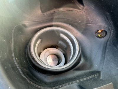

Have you checked the filler cap? The rubber gaskets can craze and then leak as tank is pressurised. Hence it’s part of the mot check to ensure gasket and flange are in good condition and seal.

Did you have a really close look for fine crazing in the rubber gasket? It's a common issue
So I went and had another look at my filler cap - last time I was just looking for damage and missed this - the rubber bit on the car that the cap sits onto had on one side raised up so there was lip over the metal. So I’m not sure the cap was sealing right onto it even though I was getting the click… Photo attached!
I’ve just moved it back into position by pushing the rubber back down on the left. Started the car up and there was no fuel smell in the cabin. Nothing particularly offensive when I got out of the car either, just ‘normal’ exhaust fumes. It’s been in the sun all day though, so if it’s an issue only on truly cold startup I wouldn’t notice.
So this may have solved the issue. I hope so - will keep an eye over the next few days. I’m not really sure though why this would only cause a smell on startup - is it some kind of build up through the potentially leaky seal that then is released when the system is pressurised?
I hope that’s as simple as it is and not an ejector stuck open.

That won't be the issue unless flap of rubber was in some way preventing the cap seating correctly, but fingers crossed it helps.
Next time you start up have someone around the fuel cap area and exhaust to see if you can detect a vapour source.
It's worth clearing out that drain in the lower edge. Nothing to do with your vapour smells, but it is designed to get any rain or even fuel spills out without running down the paintwork.
That’s what I thought. I’ll cross my fingers it was preventing the cap from seating and see what tomorrow brings. There’s definitely no damage or cracking I can see though so if not that I’d be surprised if the source is around the fuel cap.
Already cleared the drain bit out after taking the photo before I put the cap back in place so that’s sorted.
I asked my indie to clean that drain when the car went in for a service.MOT last week and he said it was blocked at both ends! Worth keeping an eye on.
An update in case anyone else has this issue.
Pretty sure it was an issue with the fuel cap not seating correctly, whether it was to do with that rubber lip or not.
None of the starts the last few days have produced any unusual smell outside the car above and beyond what I’d expect a cold-starting car to smell of… I will keep an eye but certainly no cabin smells which is good news. The proper test will be when the car has been sat for a few days.
